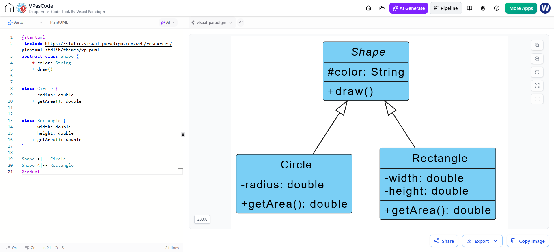

Example 1: Basic Class and Inheritance
This example shows a Shape superclass and two subclasses, demonstrating the “is-a” relationship.
PlantUML code and diagram showing Shape superclass with Circle and Rectangle subclasses demonstrating inheritance.
@startuml
abstract class Shape {
    # color: String
    + draw()
class Circle {
    - radius: double
    + getArea(): double
class Rectangle {
    - width: double
    - height: double
    + getArea(): double
Shape <|-- Circle
Shape <|-- Rectangle
@enduml

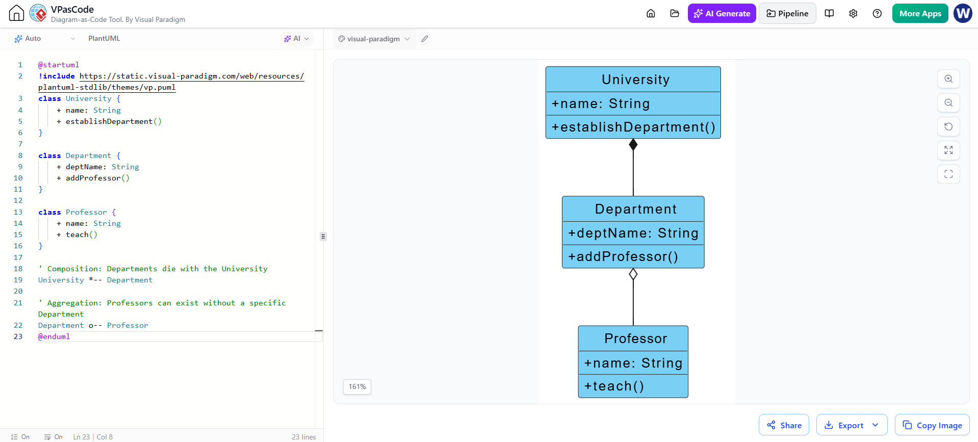

Example 2: Aggregation vs. Composition
This example distinguishes between a University (which has Departments that might survive the university’s closure in some models, but here we’ll use Composition for strong ownership) and a Department having Professors (Aggregation, as professors can move between departments).
UML class diagram illustrating Composition between University and Department, and Aggregation between Department and Professor.
@startuml
class University {
    + name: String
    + establishDepartment()
class Department {
    + deptName: String
    + addProfessor()
class Professor {
    + name: String
    + teach()
' Composition: Departments die with the University
University *-- Department
' Aggregation: Professors can exist without a specific Department
Department o-- Professor
@enduml

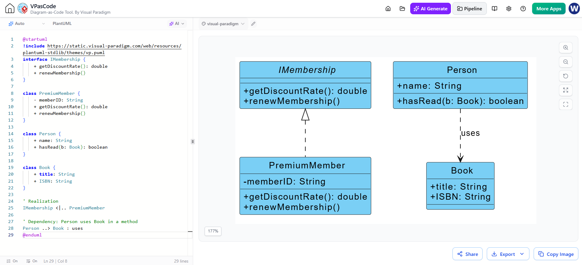

Example 3: Dependency and Realization
This example shows a Person who depends on a Book to perform a hasRead check, and a PremiumMember who realizes the IMembership interface.
PlantUML code and diagram showing Person dependency on Book and PremiumMember realizing IMembership interface.
@startuml
interface IMembership {
    + getDiscountRate(): double
    + renewMembership()
class PremiumMember {
    - memberID: String
    + renewMembership()
class Person {
    + name: String
    + hasRead(b: Book): boolean
class Book {
    + title: String
    + ISBN: String
' Realization
IMembership <|.. PremiumMember
' Dependency: Person uses Book in a method
Person ..> Book : uses
@enduml

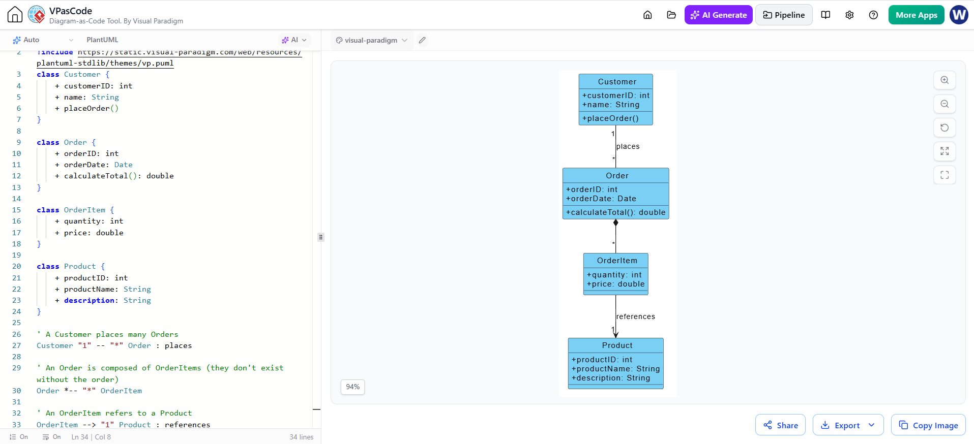

Example 4: Complete Order System
A more complex example showing associations, cardinality, and multiple relationship types.
PlantUML code and rendered diagram for an Order System showing Customer, Order, OrderItem, and Product class relationships.
@startuml
class Customer {
    + customerID: int
    + name: String
    + placeOrder()
class Order {
    + orderID: int
    + orderDate: Date
    + calculateTotal(): double
class OrderItem {
    + quantity: int
    + price: double
class Product {
    + productID: int
    + productName: String
    + description: String
' A Customer places many Orders
Customer "1" -- "*" Order : places
' An Order is composed of OrderItems (they don't exist without the order)
Order *-- "*" OrderItem
' An OrderItem refers to a Product
OrderItem --> "1" Product : references
@enduml
